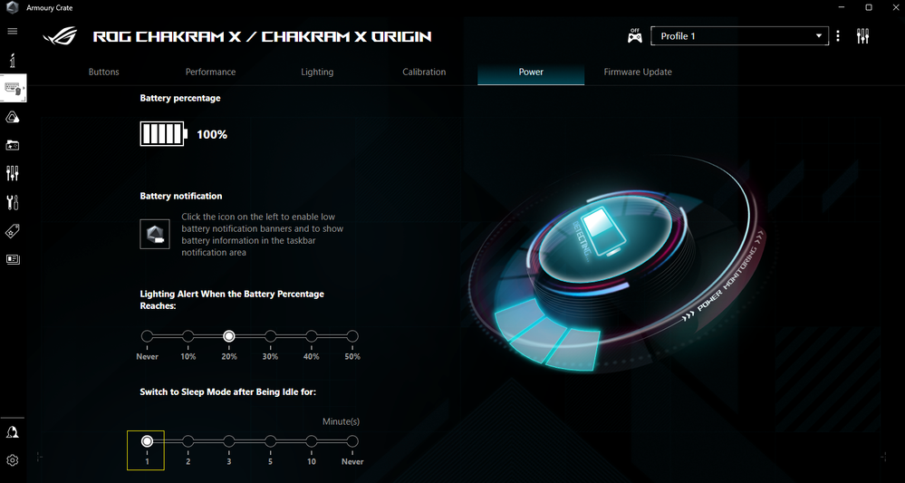

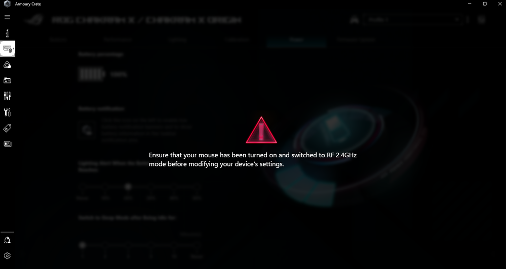

Hello
I have the ROG Chakram X (non origin) and it goes to sleep.
Try disconnecting the cable, on the power tab set the sleep timer to 1 minute.
After 1 minute, it should go to sleep and show this.
Hi,
sorry if I'm only replying now, but I was at work. As you can see from the image, I have already set the mouse parameters, but it does not go into stand by.
Sorry for my English bur I'm Italian.
Thanks for the support.

You're welcome,
In your photo,  at the bottom left on the settings tab there is a red N, this usually means you have an update. Click on the settings tab, then click update center.
What is the update for?
