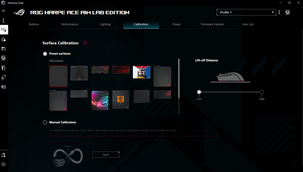

In Armoury Crate, you should have a calibration page, you can select the preset surfaces or calibrate your mouse manually.
Does this help with the jumpiness?
I would say it helped. It took a couple attempts with different speeds and it's definitely better, but it still happens occasionally. Thanks for the help, this is definitely more usable.

Some ROG mice come with a usb extender to get the wireless receiver closer to the mouse, this can help with jumpiness too. But unfortunately, the ROG Keris doesn't come with one.
Sometimes a small piece of debris can get caught in the sensor causing erratic behavior, I use a dry q-tip to make sure the sensor is clean.
