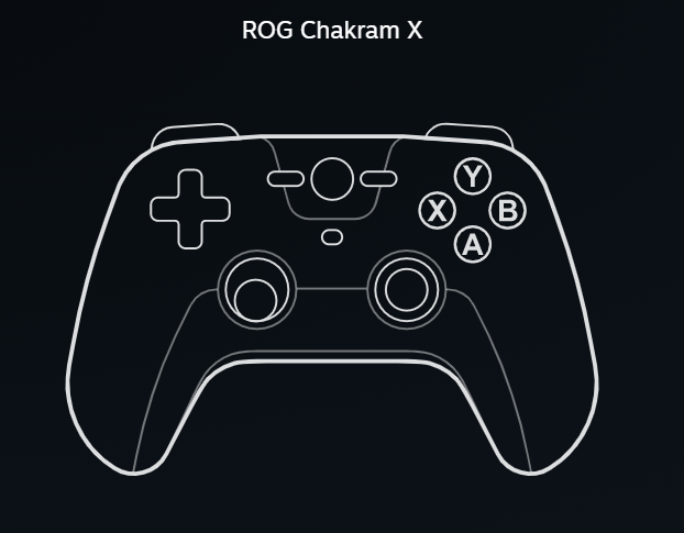

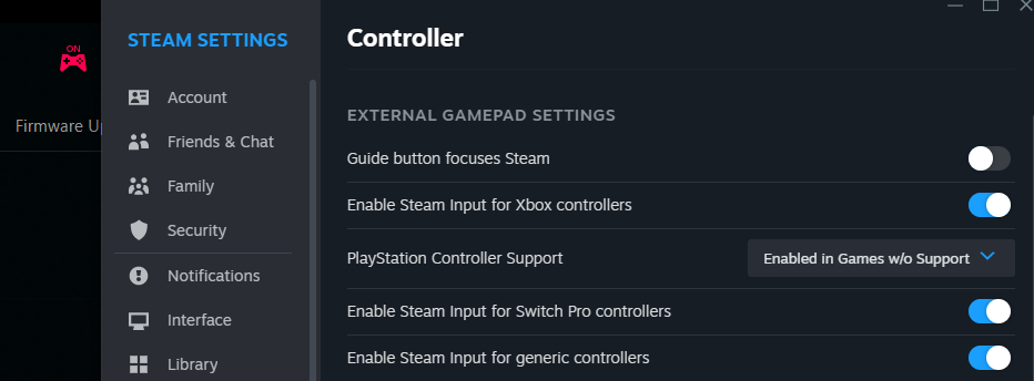

I have the exact same issue with chakram x (non-origin) version. It happens especially if the mouse is on higher than 1000 hz polling rate mode. Some times cursor does not move sometimes buttons wont work. Also, the mouse can't hide gamepad devices correctly when in joystick compatibility mode. Here is a screenshot.
When Joystick Compatibility Mode is disabled (joystick on), then Steam will recognize it.
Test Input option availableTest Input option availableJoystick moved downJoystick moved down
When Joystick Compatibility Mode is enabled (joystick off), then you do not have the option to test because no joystick is detected.
Test Input option unavailableTest Input option unavailable
