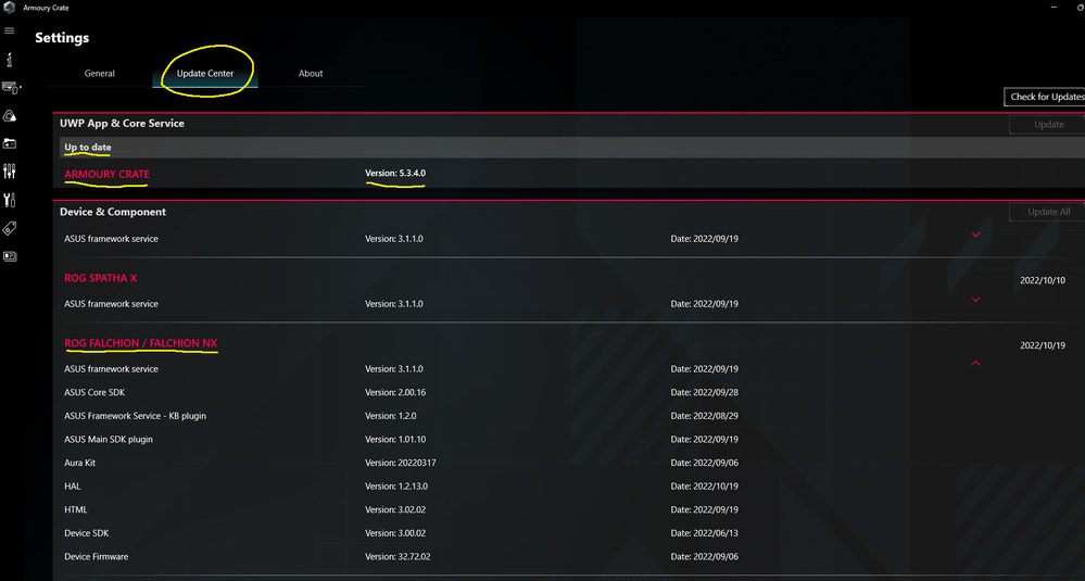

Do you have Armoury Crate installed and fully updated?
The latest version is 5.3.4.0
Click the pic to make it bigger

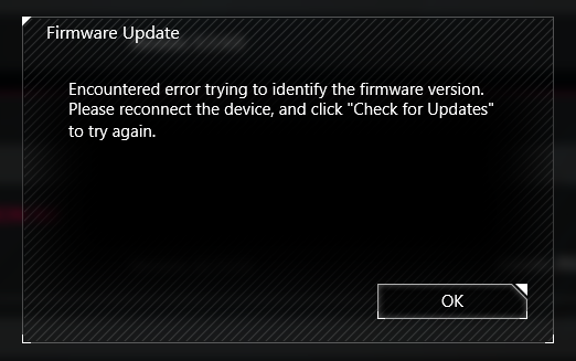

I did reset my keyboard and I do have the latest version of Armoury Crate but when I try to update my keyboard all i get is this error:
96267

I did reset my keyboard and I do have the latest version of Armoury Crate but when I try to update my keyboard all i get is this error message 96266
Nate152
Moderator
Ok,
Have you tried disconnecting and reconnecting your ROG Falchion?
When checking for updates....
Connect the usb cable to your ROG Falchion and a usb port on your pc, set the wireless switch to On, connect the wireless dongle to a usb port on your pc.
Then check for updates in Armoury Crate.
If this doesn't get it to update, I'll suggest to use the Armoury Crate uninstall tool and reinstall Armoury Crate.
In the link below, select your operating system then click "Show all" in blue, the Armoury Crate uninstall tool is the third download.
https://www.asus.com/supportonly/armoury%20crate/helpdesk_download/
Once uninstalled, let your keyboard connected like above and install Armoury Crate version 3.2.3.0, it's the first download. Then check for updates at the Update Center.
Give us an update after trying this, thank you.

It was possible to update the keyboard after a few computer restarts. Time will tell if it has helped with the original problem.

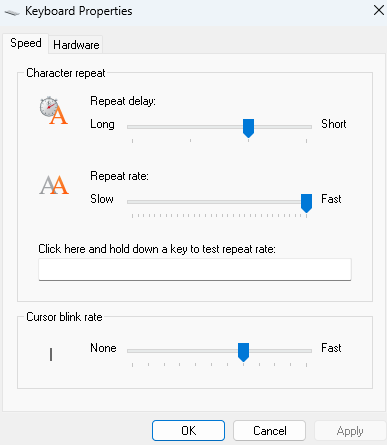

Something to try is, in the keyboard properties try setting the Repeat delay to Long.
96468
If this doesn't help, would you have another keyboard to test with? This could confirm if it's the keyboard or possibly an operating system or software issue.
