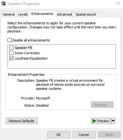

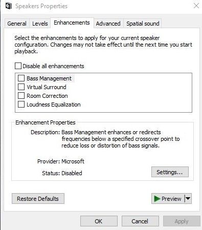

After a lot of playing around with Crate and FW, I decided that I will go back to FW v34 and Windows default drivers + solve my missing LFE channel problem. For this I used a mix of windows default effects and Peace EQ.
Warning: Crate should by no means be installed with this config.
First I downgraded the FW from latest to v34, in latest FW the back channel is louder than the front, IMO that is NOK. Front driver is a 40mm one while the one in the "back" is a 30mm so makes no real sense to leave it like that and lose volume and bass because of this.
I have made 2 configs, Stereo and 7.1. On the 7.1 config I enable loudness equalization effect from default windows sound effects to get a volume boost (good for games and movies IMO) while on Stereo config effects are enabled for PeaceEQ to work but no effects are actually used from the default ones.
PeaceEQ is set up to create a virtual LFE channel in the 7.1 config and to add a very small bass boost, nothing to extreme (feel free to change it). On Stereo only bass boost is added. Make sure you check Prevent Clipping in PeaceEQ UI. You can find the configs in PeaceEQ named My Stereo and My 7.1
Made a utility to switch between Stereo and 7.1 configurations, because its best to use one or the other based on how many channels are in the source audio. Its actually an AutoIT script so you need to compile it to an exe and add it to windows startup (when compiling to exe use an ico file from the internet size 32x32). One important thing is that you have to disable all other audio outputs for the utility to work as in the attached screenshot, change the script if you don't like it. Just add as many Send("{DOWN}") commands to navigate to the right device on your PC.

Control panel Stereo (No Spatial Sound!)
87030
Control panel 7.1 (No Spatial Sound!)
87031
