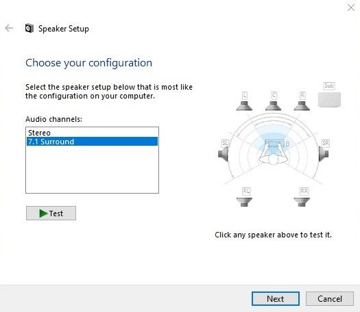

The windows way:
88762

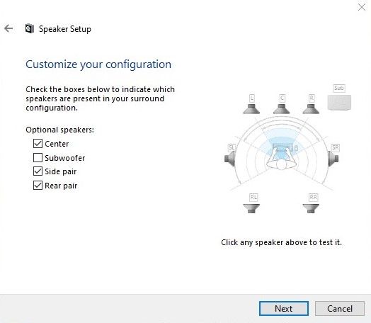

Disable subwoofer Theta is actually just 7.0:

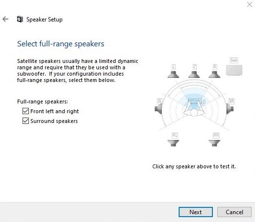

Set all speakers to full range, LFE channel will be redirected to these speakers:
88764

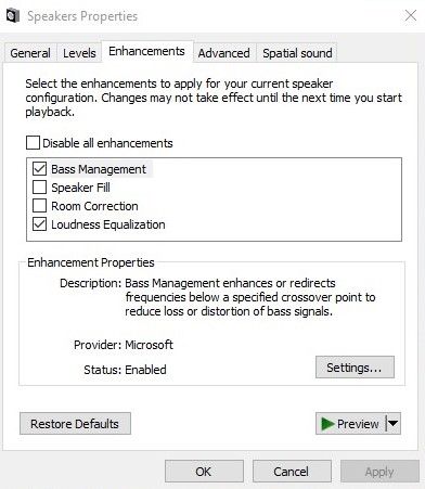

Enable Bass Management and optionally Loudness Equalization:
88765

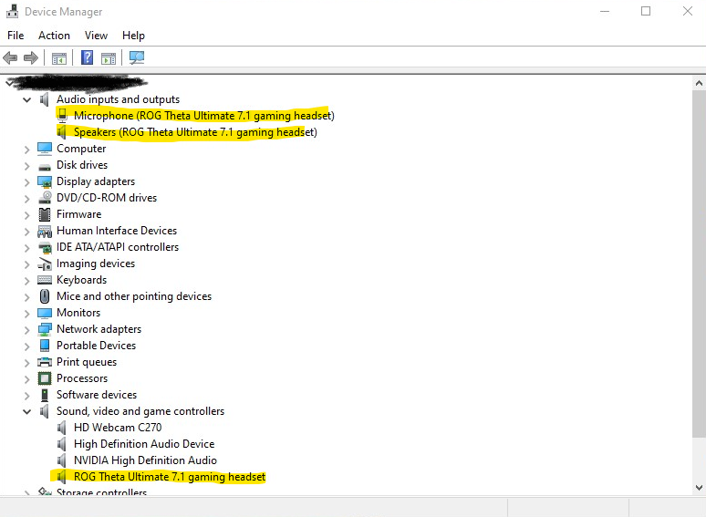

  • Uninstall Crate if you have it by using the Crate Uninstall utility on the support page for Theta (might not work all the time from experience)
  • Uninstall Armoury II if you have it
  • Go into device manager and uninstall the drivers, as soon as they are all uninstalled reboot:
If nothing works clean install windows.

  • Uninstall all drivers in device manager:
    88850
If all else fails clean install Windows, if that does not work it is a hardware issue.
    88850
