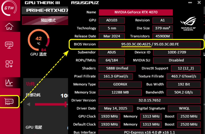

Check your graphics card’s VBIOS version
 - We recommend using the latest version of GPU Tweak III (please do not use third party GPU-Z, as it may not correctly detect ASUS VBIOS versions)

Aureliannn_ROG
Customer Service Agent
Hi @Noxioucide ,
thank you for the information you've provided.
We've passed your details on to our relevant backend team for analysis.
Please be patient and wait for any updates or messages from us.
