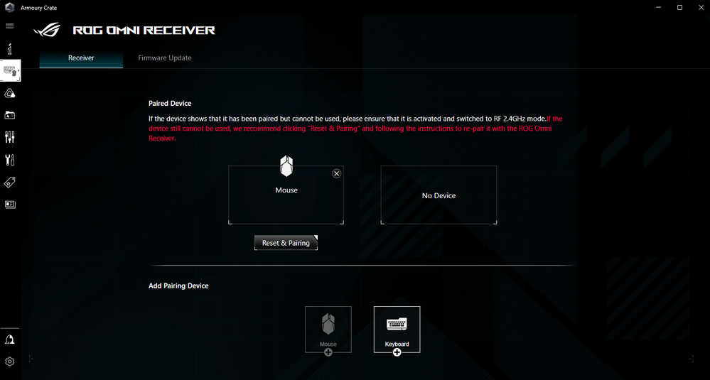

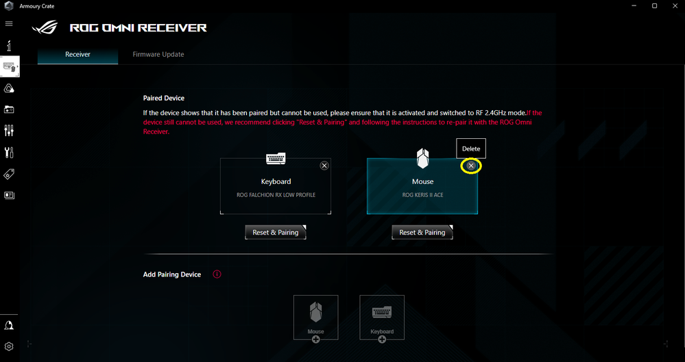

1) Unpair the Keris II Ace from the Scope II 96 Wireless Omni Receiver by clicking the X.

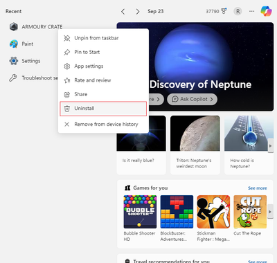

2) Uninstall Armoury Crate from windows.

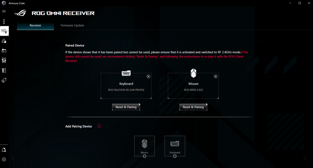

Once updated, you can unpair it and pair it to any ROG Omni Receiver. I have my ROG Keris II Ace paired with the ROG Falchion RX Low profile and all is working well.

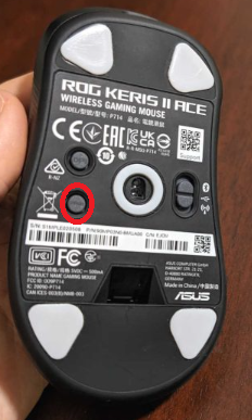

3) Set the wireless switch on the bottom of the mouse to 2.4GHz wireless mode.
4) Press and hold the pair button (circled red) on the bottom of the mouse for 5 seconds, the scroll wheel should flash green.
Push the wireless switch down for 2.4GHz wireless mode, up is bluetooth.
Does this get it connected to its own wireless dongle and working?
