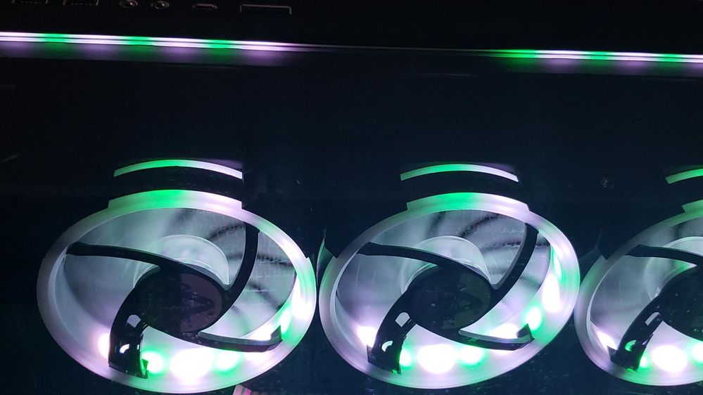

Hello!
I have this o11d XL wich has enough room and many features to try some interesting things, one of them is that you can syncronize your aRGB items with the LED strip that came with the case.

Then connect the argb terminal to the aRGB IN (or source) terminal of one POWERED hub, after that, you can connect any argb item to the hub.
88753
Remember that you must use a powered hub like this one in the picture (or any other powered hub.)
88754
ONCE AGAIN. BE VERY CAREFUL WITH THE POLARITY, CHECK IT TWICE (OR MORE) BEFORE TURN POWER ON.
