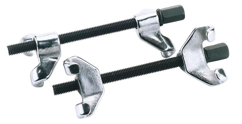

also i figured out and i custom ordered set of these with the exact lenght and 2 rows of threads that connect them to be used as tracks
