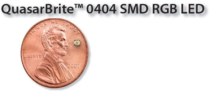

Common commercial/industrial small LED form factors ... the smallest common SMD LED size is 1104 or 1206 ... and the smallest SMD RGB LED is 5050
https://en.wikipedia.org/wiki/SMD_LED_Module
Recently introduced!
0404 (1mm x 1mm x 0.25mm) SMD RGB LEDs ... if you order 1000+ quantity, lol
https://www.mouser.ca/new/lumex/lumexrgb0404/
75141

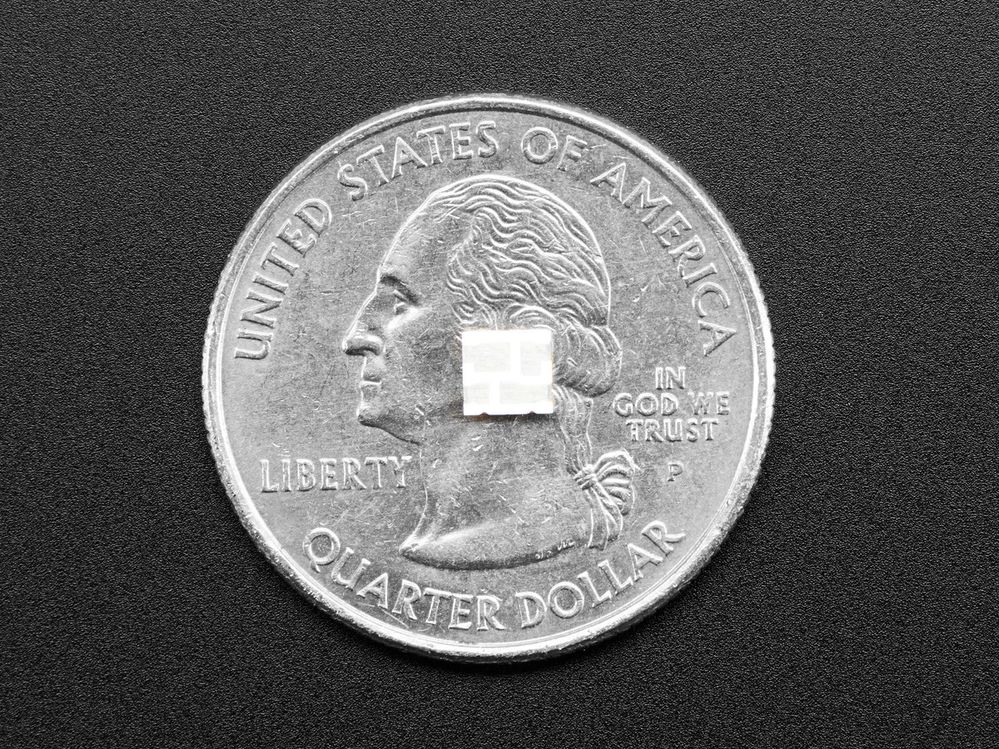

offthewall69
That is one small chip! The one I was referring to is a 3535 addressable RGB chip (his requirement); unfortunately I believe the one you cited is analog. These are available for around 5USD for a quantity of 10.
75194
I still believe however, that he would be better off with a flexible addressable light strip. He can cut to length if desired, and gang them together throughout the case for the ambiance he's looking for. Unlike the analog version, each addressable LED can be cut and spliced in individually (you need to do groups of three with analog). Here's a 16ft roll for about 27USD on Amazon: https://www.amazon.com/ALITOVE-WS2812B-Individually-Addressable-Waterproof/dp/B00ZHB9M6A/ref=sr_1_3?...
