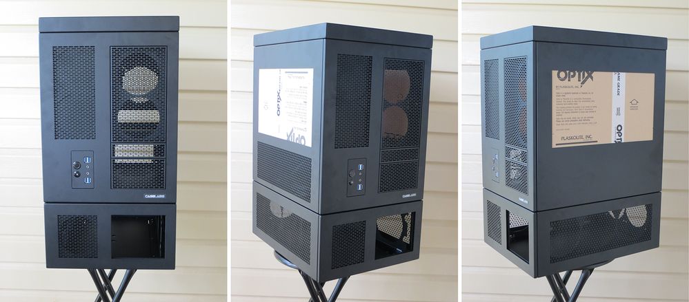

And here it is! CaseLabs Mercury S8 with Pedestal
64940
Yeap, it is big! 😄 But not too heavy... and it is sturdy...
I do like it, although it isn't perfect... simple, well made, but kinda lacking fantasy... - it is really created for modding!
I put it together (comes in pieces) in less than an hour (watched every YouTube video about assembling CaseLabs products) and started to test-fit some of the components...

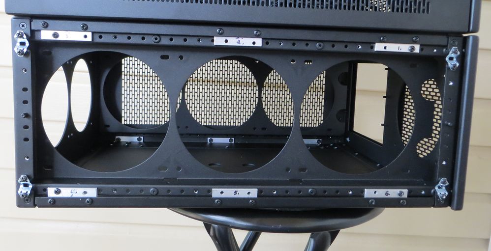

First, checked the pedestal/bottom part... I have two EK CoolStream CE 420 radiators to put there... I knew that physically they should fit, but also knew that the original radiator bracket offered will not fit these my radiators... had to do some adjustments...
Got the 420 drop in radiator mounts and mounted my rads. Had to cut the outhanging portion of the brackets... then I had to use some aluminum plates to mount the brackets (the vertical opening was too big). Also, had to set them a little bit inward to clear some screws in the corners...
64941

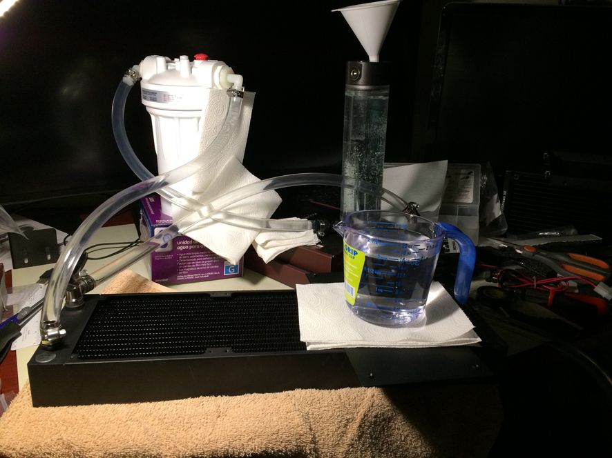

Middle of the night... flushing radiators:
65263
Built a small loop with a D5 pump, old reservoir and a household water filter. Running 1 hour with 0.6% acetic acid, then will flush with distilled water, maybe 3x 1 hour...*
