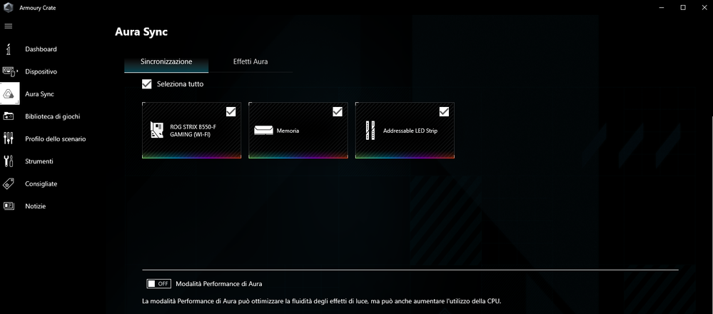

I've this problem: RGB of motherboard and RAM are OK, Addressable LED Strip KO.
I'm not able to light up the Addressable Led Strip, as you can see from the SS below, ArmoryCreate -> Aura Sync detect it correctly:
Anyway, LED strip as always worked, but I usually kept it off and I only noticed today because I wanted to change the rgb.
96935
If I try to play with Aura Creator and setting only the Addressable Strip as layer I have no results, LED Strip it's off.
To investigate hardware-side, I already verified that the connections are OK and indeed when I press the LED button on my case, all rgb light up including Addressable Strip.
So, I think the problem is on the software side on Armory Create. Can you help me? :rolleyes:

Go to the Addressable Headers section of your motherboard settings. See what gen they are set to Gen1 or Gen2?
More than likely: You're headers are Gen2 headers, but your RGB devices are Gen1 devices. So flip the setting (between Gen1 & 2) and see what happens.
You'd think that because your headers are Gen2, that setting must also be gen2, but that's not the case at all! Its very misleading.
Don't worry about not knowing 'what gen your RGB device is'. It's not very well defined at the moment (or at least it isn't well documented by the vendors for the consumers).
