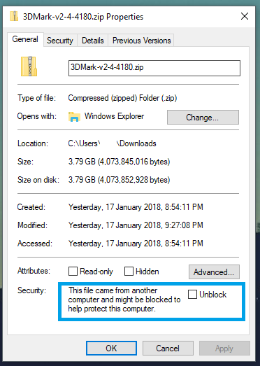

P.S. Also, right click on the AI Suite.zip file, select properties, select the unblock tick box at the bottom and apply. Then run the setup.exe or extract etc.

And, I did see a lot of "un-block" method online. However, I don't see that option in any zip file properties.
So have you ran CCleaner in safe mode yet? Also, run the registry cleaner a second time as two entries showed up that didn't in the first :eek:
It should look like this:

Thanks. I did see the screenshot somewhere but I really don't see that option in my zip file property somehow.
