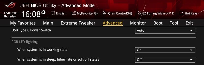

Just to clarify, you've played with these settings in UEFI already?

Yes I have- about 2 dozen times( except not the USB C Switch option). I've also toggled the ERP option a few times. And I make sure that I'm doing a cold boot after I've unplugged the system for a minute or two.
