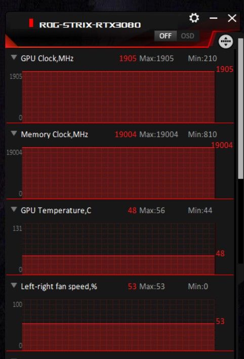

Hello so i have a few question i cant find the answer on. So i just bought a Rog strix RTX3080. So when i put it on gaming, it is supposed to boost to 1905 mhz, well it only goes up to the silent target, 1875, and on iddle 210 mhz well it's not a big difference, but it's still odd. at anyrate, i fixed that by using always 3D clock, now here is what i find odd, it's using 53% fan speed, even with 0dB fan turned on, and with a temperature at according to the monitor tool 48 degrees, way below the 55 degrees trashhold it should be on.
So another question is, does it matter if it's just running the 1905 clock all day? or does it effect the card in the long run. I seem to remember my 1080ti was running 1650 mhz all the time, so that it goes down this much is news to me.
And then one last question Power detection seems bugged out. It claims the card isnt getting enough power, when i turn off my pc, and wont stop blinking when i start it up again. I can turn off the power, and then it stops, and wont blink after turning it on, suggesting that at least isnt a power problem, but a bug that it thinks it needs power when it's off, and not correcting the error when it's on and getting the power it needs. Turned the detection off for now since it seems buggy. I hope someone can at least make it a bit more clear to me, since i am used to not needing any programs for my GPU to work as professed on the box.

I have tried both afterburner and tweak 3, it seems like it is stuck in always 3D Clock, even if it's turned off. Which i do not understand.
Ok so i solved the problem, i reinstalled GPU tweak 2, to see if there was anything i could do. But nope, so i fired up the old revo uninstaler, and removed every trace of gpu tweak 2 from the system, and restarting. Guess what. everything runs as it should, hell the clock even goes 45 mhz higher than the Gaming mode in tweak 2 gives. and fans stops spinning when it's idle.
