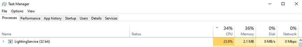

Running the latest version as of this post - I end up having to force quit the Lighting Service process, as it uses between 10-15% of the CPU resources. If I can't find a fix, I'm just going to uninstall and turn all the LED off, it's really not that important.
Anyone have a fix or ideas of what's going on? Thanks
