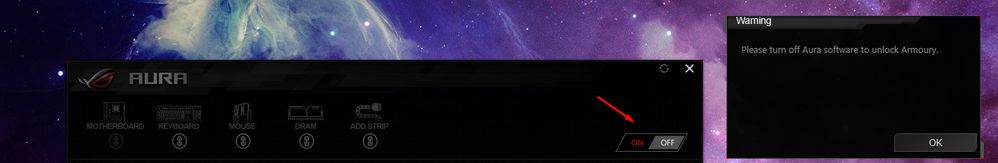

I still have this problem..
72944
72944
To be more precise, unsync any peripherals before opening Armoury (not just close the Aura software). Both Aura and Armoury can run if the control of peripherals is given to Armoury, the issue is allowing two apps control the same thing at the same time.

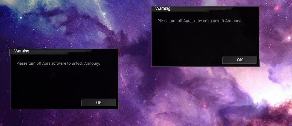

72945
I disabled AURA SYNC and rebooted the computer. It did not help(
73287
