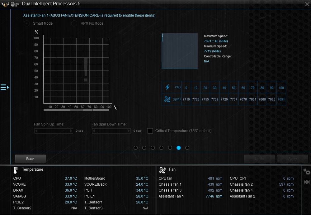

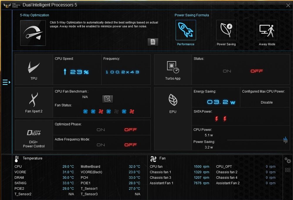

So I have tried all the above in post #141 and all combinations of fan setup with the Bios.
All my fans are PWN 4, are 4pin, 1 is 3 pin, all Nocuta PWM, thought the system supported this.
The Corsair H80v2 pump has taken a rollercoaster ride through all of these changed settings in order to figure out what settings it would remain consistent under. Currently Q-Fan is off and the pump maintains 1500 rpm steady.
If anyone has some suggestions on how i can target my fans to work like they previously would. I could have each header respond to different thermal zones on the motherboard.
The biggest annoyance is AI suite telling me I need an ASUS Fan extension card for these fans?!
70488
My other question, not sure if its because the board is Z87, but my FanXprt is only 2, not 4? Not sure if thats correct

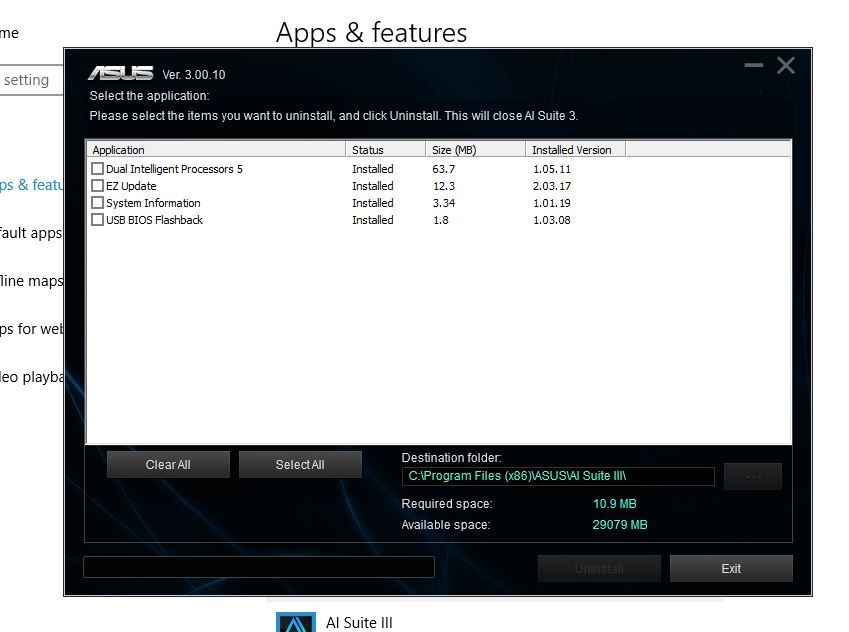

Lastly, when I goto uninstall the software, there is only 4 things listed to uninstall when installing from the beta file here.
70490
Sorry for long post, just really not sure where to go from here.
70488
You can make it work by copying data of old version into the new one. I copied FanXpert directory from ProgramData/Asus into ProgramData/Asus/DIP. And now I can set fan curves for both of assistant fans. But I'm afraid they use CPU temperature now, no thermal zones 😞
