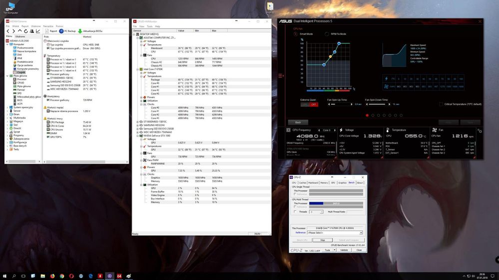

Hi, thx for beta. On Z170 Pro Gaming ver. 3 works after Windows security update. I have all tabs (not as some of users) but can see small issue while reading temps by AS3 beta and according to it - issue with fanexpert fans speed and curve.
I did some test without AS3 beta when i controled fans via bios, i checked temps , fans speed etc via other software together and separately and i have one conclusion - in stress it shows smaller temps and gives smaller fan spin speed relaying on fan curve.
While normal using i shoud have 25-35 C deg and its correct. But while small stress in cpu-z or if i play game with high cpu consumption (assasin creed origins) my fans should spin in 100% when i set their speed via bios. When i installed this beta, temps showed by it are lower in stres (about 10deg celsius) and that cause fans spin slower and temps are higher.
The temps on my pc showed by hqmonitor are correct i use it from years and i know in what case, what temps i should achive 🙂 If it can be corrected, and others also have this issue and different temps, waiting for fix. If its only my issue or z170 pro gaming issue ok, i just will move curve to achive desired speed on 10 deg less
But its worth to check.
Below screens normal using and stress (different temps all suit beta vs all other - games api's also show higher temps than as3)7027870279
