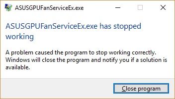

I'm having this problem, AI Suite 3 won't start but 2 fans that are controlled by it (CPU temperature) seems to be ok, and GPU Tweak 2 although running, it seems to not control my 2 fans connected to my STRIX (GPU temperature) as it should.
Should I give this BETA a try? I have a B250-PLUS with an i7-7700.
After reading this thread and seeing a lot of people having problem with this BETA, I'm afraid that things could become worse than right now.
70315
This is the error message that I get when I start windows or GPU Tweak 2.
Anyone knows if installing this BETA will solve this?

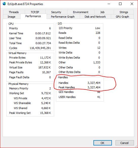

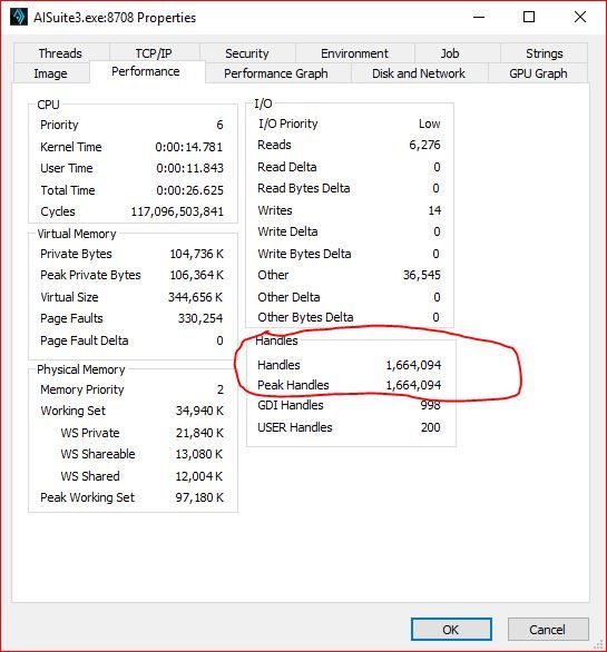

I was able to install and run AI Suite 3 Beta Version 3.00.10 on my PRIME Z270-AR.
But I'm having problem with both AISuite3.exe and EZUpdt.exe leaking handles.
AISuite3.exe is leaking handles when "USB BIOS Flashback" is installed and its configuration is set to default (Download Settings: Schedule Days 30).
EZUpdt.exe was having the same problem since the beginning (I was running it since May 2017 as a part of AI Suite 3 version 1.00.56)
It seems these application are leaking handles anytime they perform check for updates.

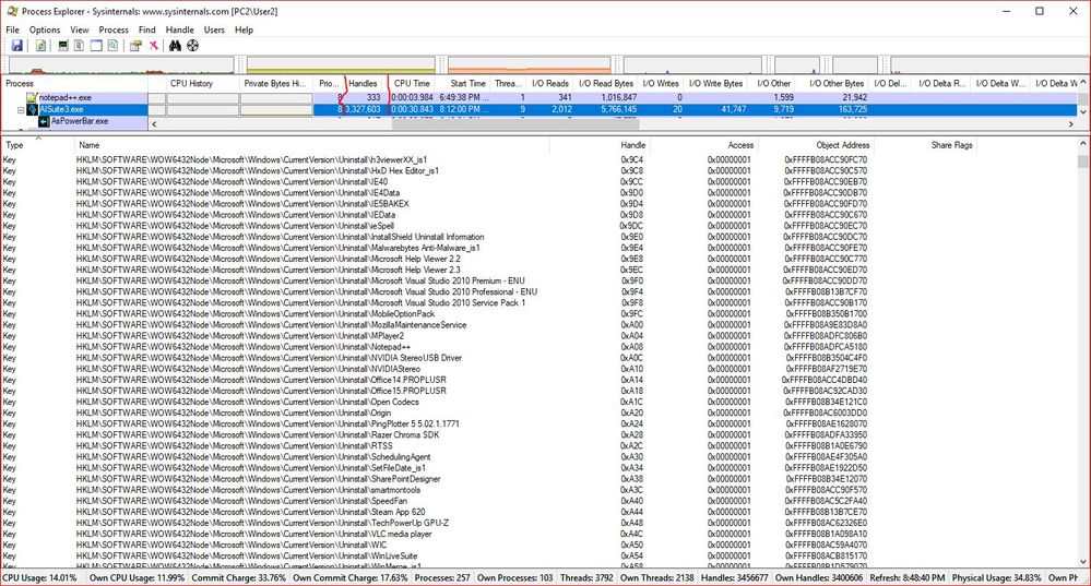

Second attached picture shows the types of handles being leaked: handles to registry keys with uninstall information
703127031370314

Great catch. I can confirm your findings.

Installed latest GPU Tweak 2 (1.5.9.1) and I'm still getting "ASUSGPUFanServiceEx.exe has stopped working" problem.
