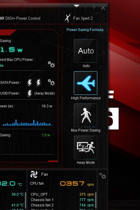

On the main window of AI Suite you can choose between 4 Power Saving Formulas: Auto, High Performance, Max Power Savings and Away Mode. Those formulas are causing the change in my windows power plan.

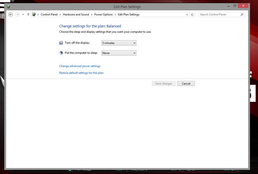

So when I put my display sleep timer manually on 5 minutes and disable my system sleep timer, AI Suite will change those two settings in my windows power plan according to the Power Savings Formula in AI Suite.
Quiller101
screenshot of AI Suite

and here is the screen shot of the values that AI Suite's power savings formula changes (High performance and Max Power Savings)
32077
Screenshot taking after selecting Max Power Savings
32078
Selecting Hig performance will change the timers into 1 hour for my display and 2 hours for the system sleep timer.
