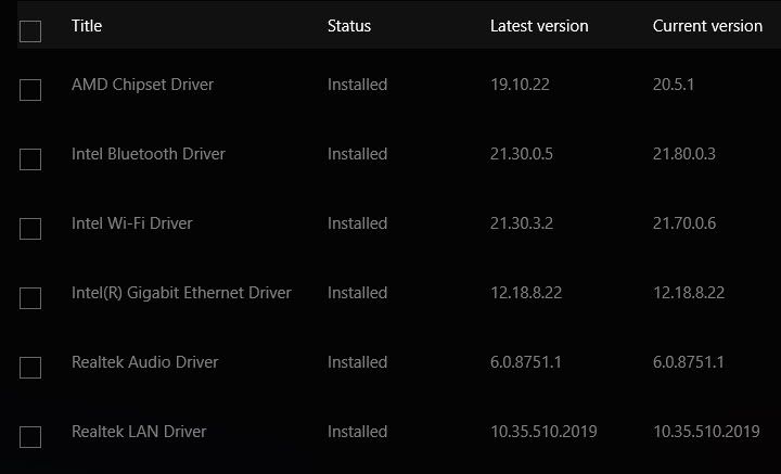

In Armory Crate I have these drivers and versions:
85238

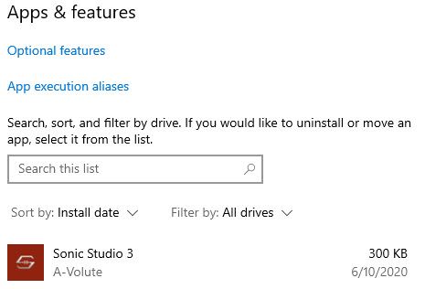

For everyone else if your having this problem check your "R-click on start button > Apps and Features" then sort by "Install Date"
I saw Sonic Radar and Sonic Studio were updated which I don't need so will uninstall them both.
Unless there are other drivers for Audio we should use?
85239
