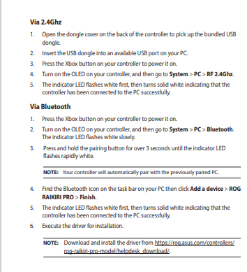

Make sure the wireless dongle is connected to a pc usb port. (No other devices)
Have you installed the Bluetooth driver?
Here are the steps to connect with 2.4GHz wireless and bluetooth.
Does this keep your controller connected?

yes all done as followed hench why its even moving ect with bluetooth and rf2.4 and the usb is dissconnected and in one of them modes the second you unplug the usb it drops off armoury crate and some games ie mw3 dont recognise it in rfid only bluetooth but then the blutooth seems to lag at times esspecialy if the controllers sat below my wood desk

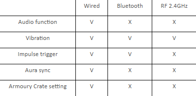

Nate152
Moderator
Try to use 2.4GHz wireless mode if you can as this gives better performance than bluetooth.
According to this chart, it looks normal for Armoury Crate to only show in wired mode.
