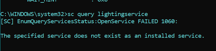

Hello, today my lighting service randomly disappeared when the system went to sleep. Its missing from the services window (checked with cmd to see if it was just visual), the registry in "Computer\HKEY_LOCAL_MACHINE\SYSTEM\CurrentControlSet\Services\", and the folder inside "C:\Program Files (x86)\".
Is are there any log files which can help find out what caused this? I'll wait for a reply before reinstalling so I don't accidentally delete them.
Device is a 2021 ROG Strix G17 G713QR-ES96Q
Canada variant with 3070, 1440p 165 Hz IPS, 5900HX, In Grey/Black chassis 🙂
Screenshots below:
Update and temporary fix!
Found the files on another laptop and put them in program files (x86)
Exported the registry key from another laptop and added to this one
manually added the service from cmd with "sc.exe create LightingService binpath= "C:\Program Files (x86)\LightingService\LightingService.exe""
Edited the registry entry path to have quotes around it so the spaces in "Program Files (x86)" dont cause any issue
Ran "sc.exe start lightingservice" in cmd
Keyboard changed colour!
Only thing which isnt fixed is it doesnt show in services
