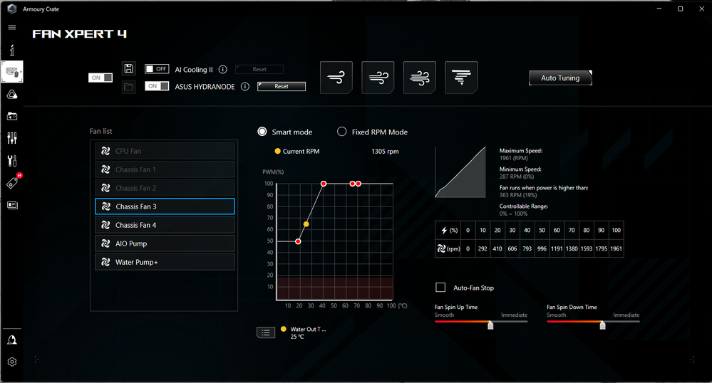

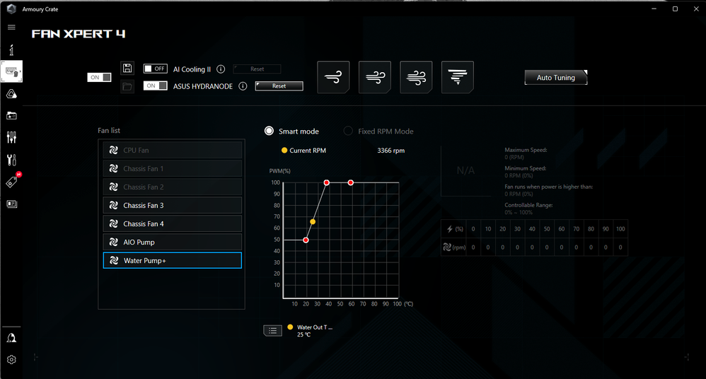

So, I've ran into this weird issue with Fan Xpert 4 where after a while (random time periods) the fans and water pump are not ramping up on the fan curves. They are sticking right at the base speeds even with temperature increases.
96124
96125
This is problematic for me as I have a custom loop and like to keep my system cool.
Changing the curves does nothing. The fans stick to the lowest speeds always.
Auto Tuning the fans does nothing.
I've tried uninstalling Armory Crate and reinstalling and it did not fix the issue.
I've tried reinstalling Windows and it didn't fix the issue.
I've tried setting the fan curve in BIOS and the same issue happens. The water temp would be above a triggered rate and the fans and pump would not ramp up.
The only thing that has worked for me was clearing the CMOS. Then and only then the fans start working on the curves again. The problem is that at random times they stop working and my system heats up again. This leads me to believe that there is something in the BIOS that is making it so that the fans are not working correctly.

After a CMOS reset and putting my settings back into BIOS the fans are back on their curve again.
96128
96129
I hope this gets fixed in a BIOS update.

Turning AI Cooling "On" or "Off" did not change the fans from ramping to the curve.
I had forgot to put that in the original post. But I had it turned "On" and the fans wouldn't work. I had actually tried turning it to "Off" to see if that changed anything before I took that picture.
