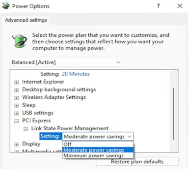

4) Try disabling PCIE Link State Power Management via Control Panel > Power Options >PCI Express > Link State Power Management

Thanks a lot, and all these methods I have tried don't work. And I have one quick update, last night I downgraded the bios version from 1415 to 1303, today, after the first boot of the computer 20-30 minutes, the computer didn't freeze. However, I leave for a break around 40 minutes after the computer boot and the computer enters sleep mode. When I back and wake the PC from sleep mode, I notice the computer reboot, and there is a blue screen code which is related to the GPU driver.
