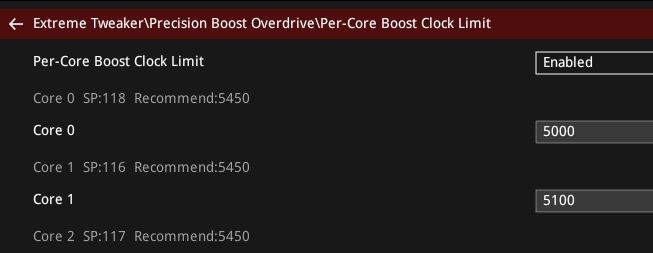

Shamino wrote:
adds per-core frequency limiter
95639
Hi Shamino,
Are you aware that enabling this feature when SMT is disabled results in the motherboards failing to POST? This is also true of the asynchronous BCLK configuration when SMT is disabled. This is true of my Crosshair Hero, but I suspect it may be true of all X670 boards. Is there a chance that both of these bugs can be fixed?
Castillan wrote:
Hi Shamino,
will be fixed next version
