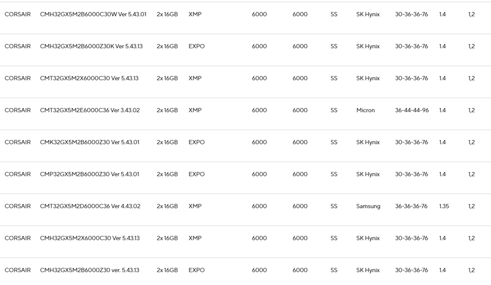

These are the 2X16 6000MT kits present on the memory QVL for the PRIME B650M-R. As this is an entry-level board, validated memory kits are fairly sparse. I'd recommend opting for one present here for the best possible chance of success without the need for manual tuning.

Thank you for this. I guess the so called "compatibility filter" on PCPartPicker is no good then. I'll look into buying some RAM off that list but do you know how and could you please tell me howI could tune the existing RAM to work as you seem to imply that that's a possibility?
There's no assurances with overclocking, unfortunately. The vendor QVL simply ensures you get the best possible chance of success - if you can return the kit for one present on the QVL, I would do so 👍
9800X3D / 6400 CAS 28 / ROG X870 Crosshair / TUF RTX 4090
I exchanged the RAM kit for the cheapest one from the list (which just so happened to also be a Corsair Vengeance kit) and it has worked perfectly for a couple days so I'll call this solved, thank you for your help, I'll certainly check motherboard compatibility for RAM from now on instead of just trusting PCPartPicker
