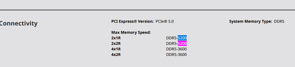

The processor officially supports up to 5200 in 1 DIMM per Channel configuration as per the AMD product page. Anything above this can be considered an overclock.
