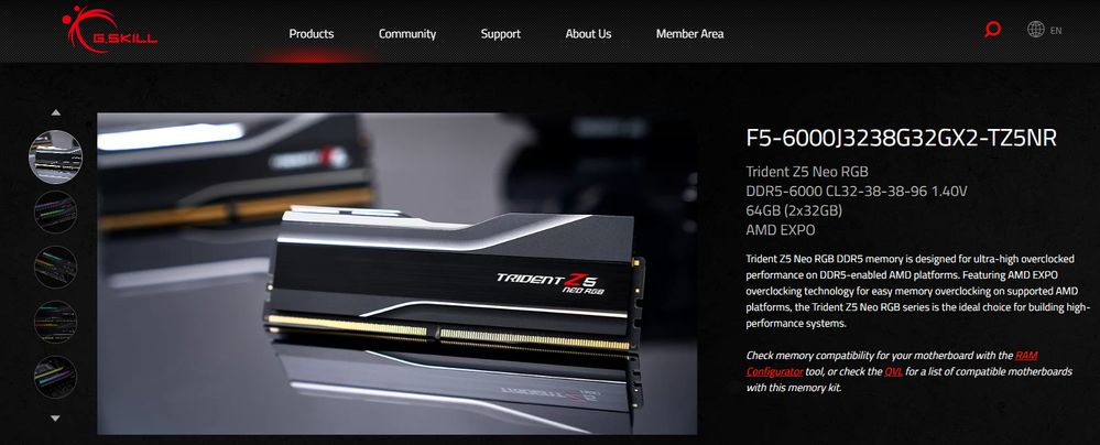

Hello Bassel1993
The memory should work, but X.M.P. won't work as this is for Intel motherboards.
What you want is Trident Z5 Neo. If you didn't want to return it, you could try setting the ram manually to these specs.
