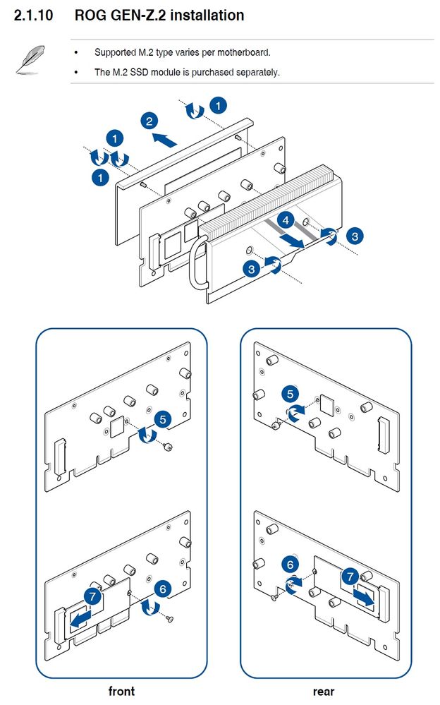

My plan was to put my 4090 in PCIEX16_1 to run X16.
But the manual seems to suggest if I install an M.2_1 or M.2_2 or Gen-Z.2 I'll but stuck with PCIEX16_1 at 8X and my M.2's at 4X?
Puzzled at what configuration I should be using ... should I put my two Samsung 980 Pro 2TB 2280 M.2's in the single Gen-Z.2 module or put them in the M2_1 and M2_2 slots on the motherboard?
Thoughts?
Cheers, Rob.

It's confusing because M.2 Gen 4 are X4 ... the lanes supported are X16 X8 and X4 ... I don't understand why two X4 M.2 Gen4 SSDs would force PCIEX16_1 to 8X?
So where does the Gen-Z.2 fit into all this (it can house two M.2)?
So basically I have to buy ONE 4TB M.2 Gen4 X4 (rather than use my existing 2 2TB M.2 Gen4s) and my 4090 and that's it? Ugh.
Cheers, Rob.

Does the Gen-Z.2 use only four lanes, or eight, given it can house two M.2s? I'm not sure. If it's eight, that would explain it. There's really only 4 to spare. At least we're not Intel, they don't even get that much.

For the optimal performance you should install your nvme drives in the slots that are served by the CPU directly and are not bifurcated.
On x670e extreme the fastest slots are
M.2_1
GEN-Z.2_1 (on the right side of the card)
Avoid M.2_2 as it is shared with PCIEX16_1 (where your GPU should be) and GEN-Z.2_1 as it's connected via X670e chipset that is sharing the lanes with other devices such as LAN and USBs.
Hope this helps,
Max
Rob_Ainscough
Hi Max,
Thanks for the response, so my best performance setup is:
4090 (or 7900XTX when released) in PCIEX16_1
#1 M.2 SamSung 980 Pro 2TB in M.2_1 (on motherboard)
#2 M.2 SamSung 980 Pro 2TB in GEN-Z.2_1 (front or rear, not sure your reference point for Left/Right?)
96169
Will that keep PCIEX16_1 at X16?
Cheers, Rob.
Rob, that's my understanding reading the manual. If you try it, please report back on whether this works to keep the GPU at X16.
