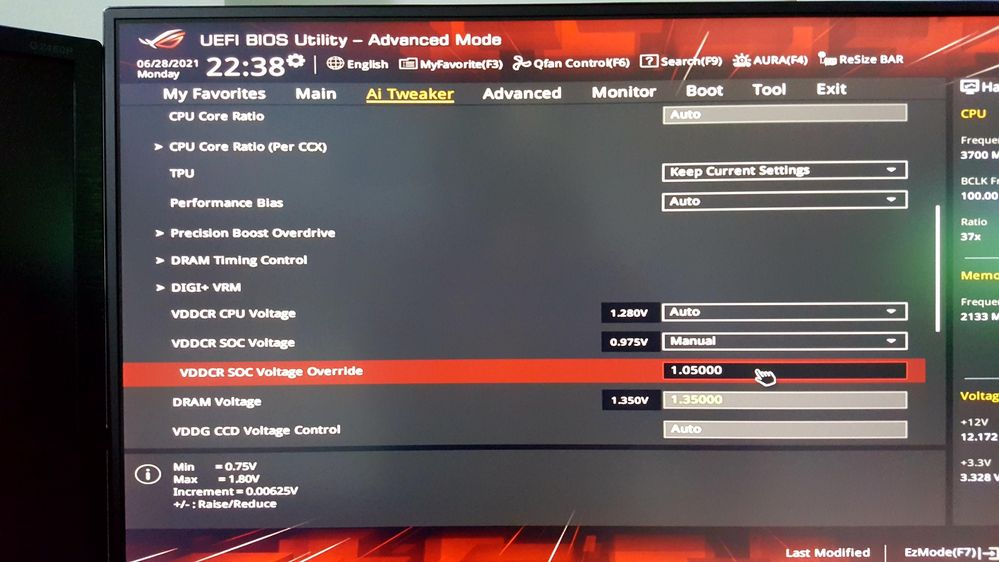

RedSector73 wrote:
Must just be a minor difference between the motherboards. I'm using CH8 wifi to provide you the details. "Ai Tweaker" is the same thing.
on auto you select manual and open for you input the value.
I will put this value with sign "+" its ok ?
89172
Sorry for the insistence, im very noob with all this things and I have very bad luck sometimes 😕
RedSector73
Level 12
Looks good 🙂
save and exit and see if you get boot
qcode Od is memory training error, if you get boot and get sudden reset without warning in windows, just means the value is little low and try next one higher so, 1.1v
not sure what you mean by + use. You want to use the manual setting.... the + and - setting are from the default value / setting and this would not be good. The setting is a manual setting of the voltage not + or -. The + or - are, added or taken, from the default value which on your screen is set @ 0.975v
down the very bottom of your screen you can see min to max ranges allowed for the SOC of between 0.75v to 1.8v. I've not read of anyone exceeding 1.2v for SOC, stick to 1.05, 1.1, 1.15 and maybe 1.125 I would not go higher than these values and gave most likely ones to work in earlier post.
at least your trying and asking questions is good way to learn. Hope my answers are helpful.
RedSector73 wrote:
Looks good 🙂
I just tried with the values ​​1.05; 1.1; 1:15 and it didn't work for me. When turning off the PC completely from the power supply, when turning on it keeps throwing the error 0d and DRAM 😞
