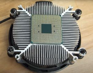

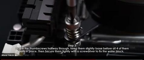

Since the only thing you changed was the AIO (back plate too). You can try to loosen the four bolts around the CPU bracket one-quarter to half a turn each (spring or coil spring will still apply pressure). I hope that this will clear the q-code error.
Sometimes when I change out my CPU water block or reapply thermal paste, I get a Q-code 03 or Q-Code 55.
94906

I see thanks. Currently using an amd cpu with 2 bolts setup on the radiator mount. I guess I need to loose these bolts and apply pressure bit not letting the spring compress fully?

I hope it works! Back in the days with fan heat sinks, this happened sometimes with AMD CPUs, no problems with Intel CPUs.
94907
These days with AIO or CPU water blocks, the compression effect with springs or coil springs is too much when over tightened (some to the point of bending or flexing the motherboard/CPU Socket).
