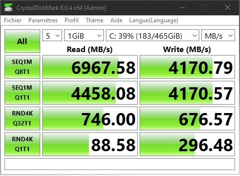

Thanks for your input. I remember seeing one of these articles. My SN850 is installed on the top M.2 port which I believe is the CPU M.2 slot. The drive shouldn't be slowing down unless there's a bigger flaw/underlying design issue. In fact, I just ran Crystal Disk and the results seems to be in specs. Wouldn't hurt to try to rule it out definitively though.

Just check you have latest firmware installed for the M2 via WD software. Yes, Top is CPU M2 on this board.

I do have the latest BIOS, WD Dashboard is installed and confirms I have the latest firmware.
