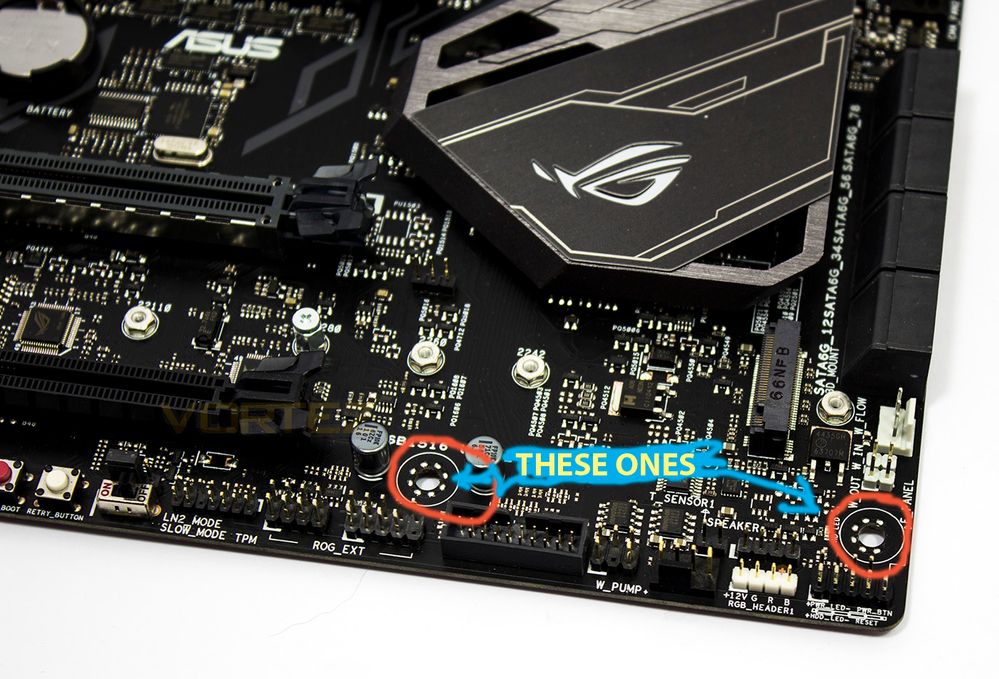

So I've printed and secured a fan to the m.2 fan holder but can't seem to find a good way to attach it. Has anyone had any luck? It looks like I need longer screws and spacers or standoffs.

there are 2 motherboard screws below the M.2 slot (ones that secure the motherboard to the case.)
unscrew them and then they go through the fan holder you printed, through the motherboard and into the case.

Those mobo holes look metal-lined, like they're attached to PCB ground plane and are meant to have metal screws and metal standoffs and metal chassis, lol. I'm a firm believer in having proper electrical contacts, lol, at least on high-spec or overclocked hardware.
But you can probably use longer screws if the existing ones aren't long enough to tap through your M.2 plastic to the mobo to the standoffs. Shouldn't cause any electrical faults. You might need to be careful about mechanical stress, don't overtighten the screw and crack your mobo PCBs.

These were the ones I used. Just slightly longer than the ones that came with my case:
https://www.amazon.com/gp/product/B01DAOETHM/ref=oh_aui_search_detailpage?ie=UTF8&psc=1
I liked the wide head to avoid cracking the 3D plastic bracket. Size is 6-32 x 5/16. If you need longer, the next size up would be 6-32 x 3/8.
