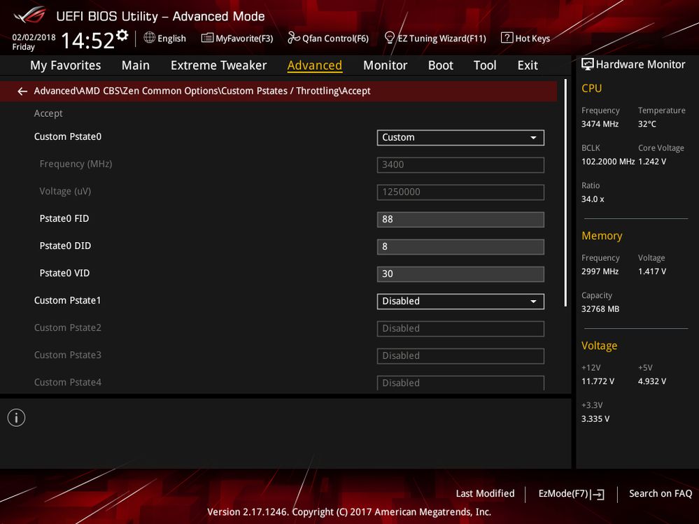

Old (tested stable) OC settings were P-stated to around 3.8 Ghz and 102.2 Mhz bclk, RAM 32x. Voltages were near stock, I stopped at those OCs because any further would require much higher voltages that I weren't even comfortable with testing. Ran those OCs for about 4 months without a problem.
