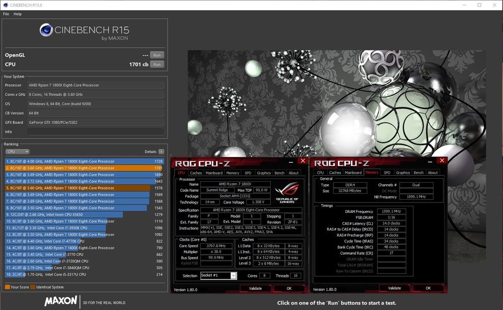

mito1172 wrote:
Processor stock speed is only 3.6 GHz
Thats wrong. If in the bios the Turbo is enabled and no manual oc is set, the Cpu frequency goes up to 3,7Ghz at this C6H.
Measure it with HWmonitor.
From 3,6 to 3,8 Ghz @Cpu the reported temps are correct and the system is stable.
When reaching 3,9Ghz and above, the system isnt stable, i had a crash in Cinebench and some while the system rebooted.
(might be because i dont wanted to go above 1.35V)
But so far about the cpu..
I was able to OC my ram from 3000 to 3200 above the max XMP info from the Ram without changing the timings,
for stability safety i did increase the voltage from 1.35 to 1.37.
Now my Ram runs at 3200 dualchannel CL14 1T stable, tested it serveral times with CB.
There is only a reading error of some programs or the sensor which is on the mainboard i guess.
Because my cpu runs at 3,8Ghz and not 3,6Ghz if this score would be with 3,6Ghz (as u can see in the picture below) i would be proud of this cpu 😉
But it isnt, anyway a good result, the Ram increase made a difference +10points to 1701 funny that this was the previous bios that ive used 😄
70020
My system crashed many times in row trying to get again on 3200, it didnt worked suddenly, so i went down to 3140
Now its at same timings again stable but the voltage is at 1,35 as it was before with 3000.
Also updated my cpu info, for encoding safety it runs at 3,8Ghz 1,35V and use at CB 130Watt.

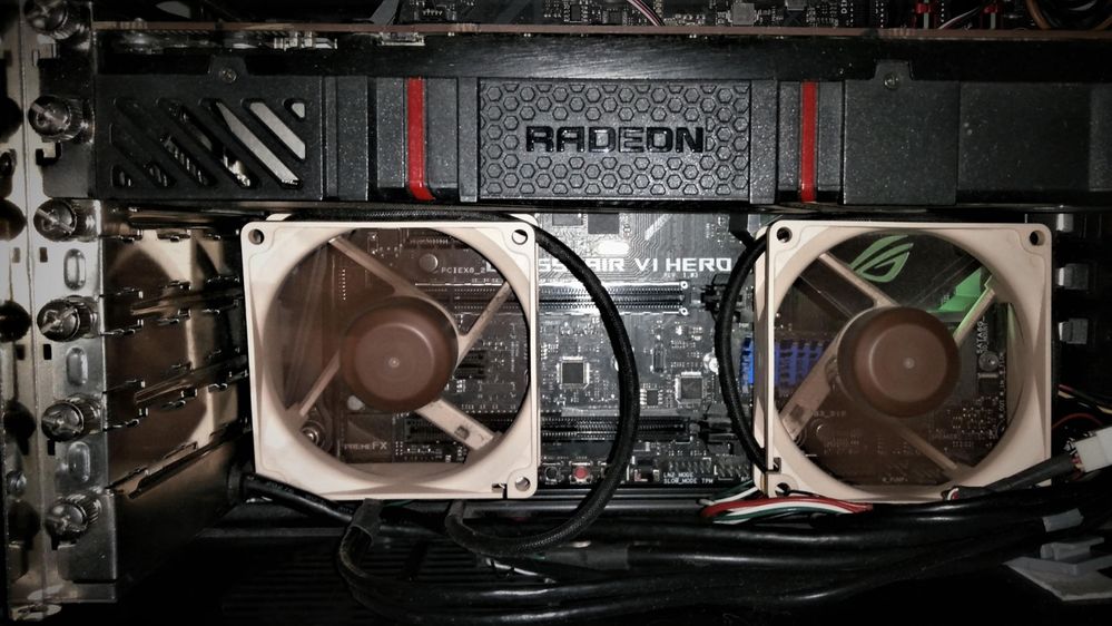

I would just like to take the opportunity to report my solution to all my problems with
fans jumping into full speeds and processor temperature erratic fluctuations.
I tried all BIOS from 901 to 1501 but stayed on 1403 as that worked best for me.
I had five months (apr-aug) of almost daily problems with restarts in order to run this MB.
For these last four months (sep-dec) I have had not a single problem with this MB.
What I did was installing a small 80 mm half speed quietly running fan onto my MB.
The fan is placed laying over and ventilating the problematic sensor chip (left fan).
I also put a fan over of my M.2-SSD to cool that drive (right fan).
Happy New Year to all of you out there !!! 🙂

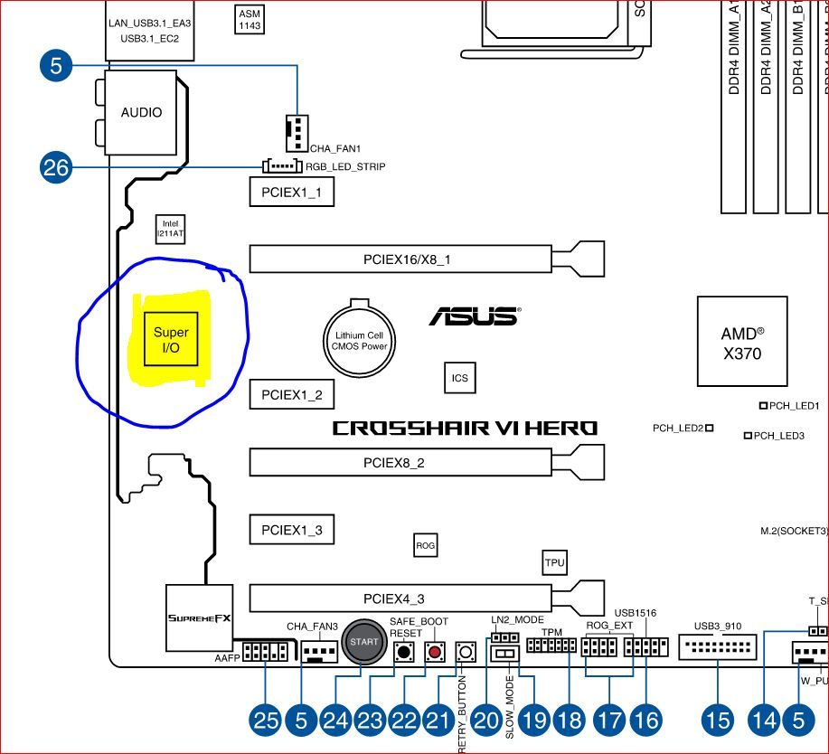

Interesting indeed! Now thinking about additional heatsink 4 the chip. Maybe, it'll be useful.
By the way, which chip exactly? Currently too lazy 4 opening the case and searching fan area - evening...

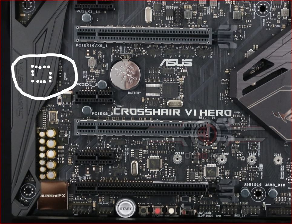

It's the SUPER I/O chip in this picture. The chip is hidden under the plastic cover just bellow the graphic card slot.
A heatsink can't be fitted here, but a fan can ventilate the chip.
70037
70039
[Eaten by mice]
Thanks! Looking on the images, I understood, why the MB is working 4 me. CPU & GPU are liquid cooled, case is large, and it's not too hot in the area. But something with regular cooling...
By the way! The plastic can be easily cut after warranty period. Not steel indeed 😉 (I already made a large hole in metal, when moving a PSU in Fractal Design Node 304 NAS case) After hole in the plastic - thermal glue and heatsink is installed. The area is hot, but self-made heatsink may be long; 5-10 cm upper and the chip will be cool. Required piece of aluminium is not a problem 2 find.
P.S. placing such chip under plastic is NOT good indeed. It should be somewhere near post codes indicator.
