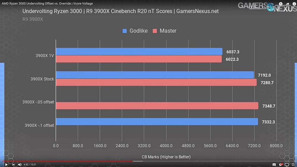

On the same topic of undervolting, Gamer Nexus just made a video about this.
He loses a lot of performance by setting a VCore of 1V, which is kind of expected imo... but with a small offset (even 0.1V), he gets better temps and almost exact results, some losses of 1% there and some gains of 2% here... kind of my results too.
GN VIDEO
