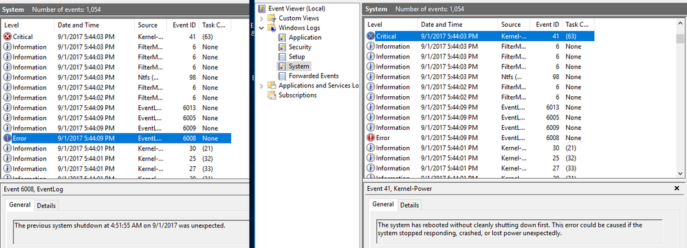

Here is an interesting observation that I have been experiencing every time I experiencing cold boot issue without turning off PSU.
I always experiencing cold boot everytime it takes few extra sec to react to shutdown request; literally nothing happen and and go to the windows shutdown screen few sec after.
and upon next boot, I always get hit by the cold boot. It will try to train the memory again but restart with ram @ 1866.
So I normally just try to get into BIOS and exit without changing anything to get it recongnized the ram @ 3200.
And upon entering windows, I will always see those 2 event showing up on windows event info.67079
as you can see, I turn off my computer @ ~5AM and try to turn it on ~5:45 PM.
I dont force computer off or anything, simply just click on Shutdown and wait for it to turn it off.
Everything is stable, and if I dont see the extra few sec for windows to react to the shutdown request, the next boot doesn't come with cold boot issue.

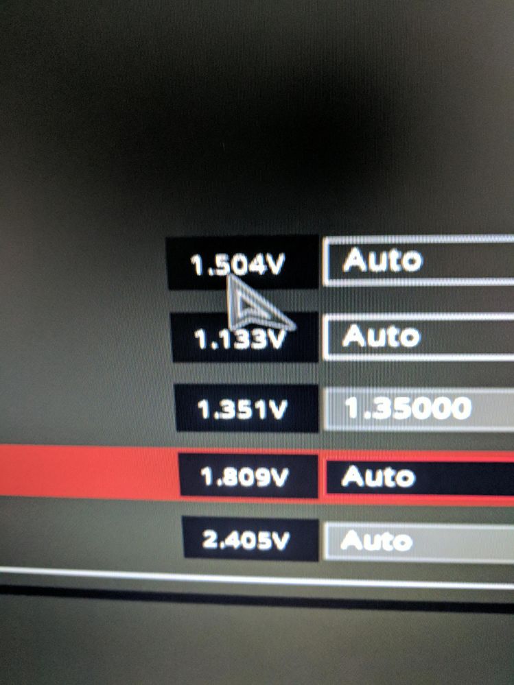

Well, while it didn't solve the issue that I was experiencing, I had different solution for my own issue.
with 1701 BIOS, I actually reseat my CPU and I haven't had cold boot issue since. However, it only works without CPU OC.
While my O.C is stable with IBT and reachbench stress test, it seems that the board is having issue to boot it up properly.
And often when I enter BIOS after cold boot issue, I will notice that the voltage reading will be ****ed up and experiencing freeze in BIOS.
here is one of the example, where 1.05v gets shoot up to 2.4v
68067
it's just one thing that can happen.
sometimes the 1.8v will go crazy, or 1.05v will go as low as .24
And the worst happen is SoC voltage will ignore the assigned value and stock @ .8xx v
right now, I am just chill with CPU default + O.C my 32GB Flare X @ 3200 with memory fail count set to 3 and no cold boot issue.
